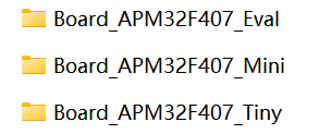

Hello, since both APM32F407RG and APM32F407VE are part of the APM32F407 family, they share the same User Manual, code base, and IDE settings.
For your software development:
You do not need to worry about which specific model (e.g., RG, or VE) is used in the Example project.
We recommend using the Example’s default configuration directly.
Please ensure you use the “APM32F4xx_1024.FLM” Flash programming algorithm.
The only difference between the APM32F407xE and APM32F407xG variants is the maximum Flash capacity; otherwise, they are functionally identical for development purposes.
